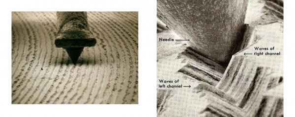

Vinil se topi pri 248 C
Pri igli v brazdi je 160 C, lahko tudi več, - je nameril Van den Hul
Še malo pornografije:
In Glen Ballou's 1991 "Handbook for sound engineers" there's a chapter written by G.Alexandrovich (Fairchild Recording Equipment) about vinyl recording and playback.
The vertical tracking force applied to the stylus is
divided between the two walls. Each wall is experiencing
force that is equal to the total vertical force times
the cosine of 45° or 0.707, Fig. 27-26. For instance, if
the vertical tracking force (VTF) is 1 g, each groove
wall will experience a force of 0.7 g.
A very small area of contact exists between the
stylus tip and the groove so the pressure against the
groove wall can rise up to many thousands of pounds
per square inch. For instance, if each wall receives 0.7 g
of force applied through the contact area equal to two
ten millionths of an inch (0.2 × 10–6), the pressure is
7726 lb/inch. With such high pressures and force of
friction between the stylus and the vinyl, the outer skin
layer of the record material melts as the tip slides over
the plastic and then refreezes almost as fast as it melted.
Since the melting temperature of the vinyl is about
480°F, the same temperature exists in the contact area.
If the record material is metal, which happens when metal mothers are played, then the pressure increases to 20,000 to 30,000 lb/squ.inch, and the temperature can reach 2000°F because there is no plastic deformation of the groove wall. This explains why styli made of diamond, which is nothing more than carbon, literally burn up or wear out in a couple of hours when they are used to play metal mothers. If liquids were used to cool the contact area, then the diamond wear diminishes drastically, but the metal surface of the record is burnished. If the liquid is applied to the vinyl surface, then the temperature of the plastic surface cannot reach increase and melt; therefore, the scouring of the groove wall can be observed, as shown in Fig. 25-114.
Skratka,- kjer se zares dogaja ni nobene nebeške poletno-spomladanske večerne romantike , ampak pekel... Žge in hajca, čista "jeba", .....skratka pornič.
http://www.aes.org/e-lib/browse.cfm?elib=1016
