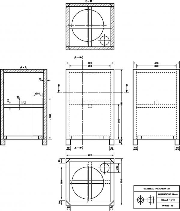

box:
Technical data:
Drive unit 300 mm, Monacor (SPH-300TC)
Dimensions of box 660×406×420 mm incl. legs
Volume of box about 65 l net
Type of box bass reflex
Nominal impedance 8 Ω per channel
Efficiency 88 dB W–1 m–1
Frequency range 45–105 Hz
Loading max 250 W per channel |
