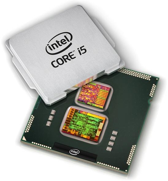

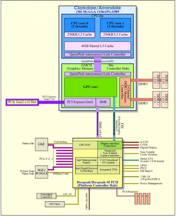

intel core i3, i5 procesroji z vgrajeno grafiko (clarkdale)
odpade grafična kartica, bolj hladno.. majša poraba...manjše ohišje...
http://www.techpowerup.com/reviews/Intel/Core_i3_540_530
http://www.anandtech.com/cpuchipsets/showdoc.aspx?i=3704
http://hothardware.com/Articles/Intel-Clarkdale-Core-i5-Desktop-Processor-Debuts/
For a HTPC there's simply none better than these new Clarkies. The on-package GPU keeps power consumption nice and low, enabling some pretty cool mini-ITX designs that we'll see this year. Then there's the feature holy-grail: Dolby TrueHD and DTS HD-MA bitstreaming over HDMI. If you're serious about building an HTPC in 2010, you'll want one of Intel's new Core i3s or i5s.

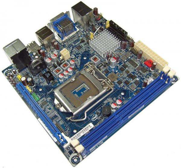

še matična (format mini atx!) na katero pašejo zgoraj omenjeni procesorji:
Intel DH57JG “Jet Geyser”
http://www.anandtech.com/mb/showdoc.aspx?i=3752&p=1

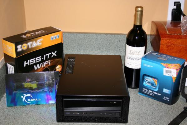

praktičen primer:
http://www.mediasmartserver.net/2010/03/11/building-a-mini-itx-htpc-2/
glavna komponenta: Cabernet Sauvignon Laughing

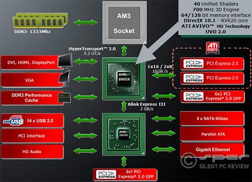

AMD's 890GX Chipset (newest high-end integrated graphics chipset)
http://www.silentpcreview.com/article1032-page1.html
http://www.anandtech.com/cpuchipsets/showdoc.aspx?i=3755
PrispevekObjavljeno: Pon Mar 22, 2010 13:46    Naslov sporočila: Odgovori s citatom
V vednost pri nakupu. Pri platicah z integriranimi graficnimi je potrebno biti previden in pogledati ali podpirajo 8 channel LPCM preko HDMI. V primeru, da imamo zeljo po podpori za Dolby TrueHD in dts-HD je slednje nujno.
