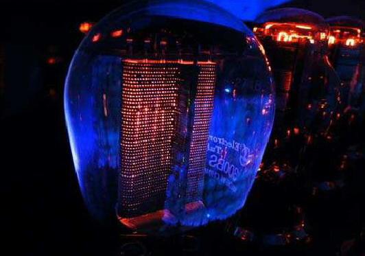

300B MASH v čisti A-class.
Bojc

Ravno ,ker je Bojc objavil v bistu "sexy" (lep nočni videz) lampe...
Pred meseci je nekdo iz Srbije prodajal nov par teh lamp Shuguang 300BS, za solidno ceno..
Me je že imelo da jih kupim - za rezervo, pa jih nisem.... Potem je nekdo na AK prodajal eno samo tako lampo in sem jo vseeno vzel za smešno ceno, da testiram zvok (- samo na enem monobloku). Prodajalec je rekel,da mu je ena šla po 50urah,tako je ta ,ki sem jo vzel imela 50, pri meni pa naredila še 20ur in "usahnila"... Zvok sicer"prijeten",a s "pomankanjem"na visokih..
Dobro ,da nisem kupil novega para - očitno teh Kitajskih j**c.. Ali zgolj slučaj? lp

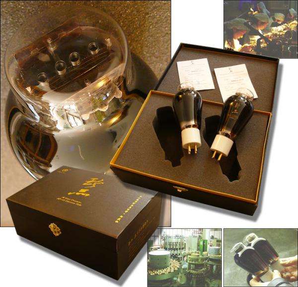

SHUGUANG Treasure Series 300B-Z
Uporabljajo novost @High Polymer Compound Carbon (HPCC)"
Shuguang is the oldest and largest tube manufacturer in China, established in 1958 by engineers educated and trained in the United States in the 30-40s. Shuguang's vacuum tube production accounts for the world's 40% total tube output nowadays, either under their own brand "Shuguang" or under OEM brands. Generic Shuguang tubes are constructed in clear glass enclosure.
The Treasure series use a carbon compound coating inside the tubes making them appear to be 'black bottle'.
This series were released in Dec 2008 to celebrate Shuguang's 50th anniversary, after 3 years of testing under extreme conditions, Shuguang has successfully adopted technology in vacuum tube construction to achieve directional solidification and single crystallization, which greatly improving the ability of electron emission and electron current stability.
As a result of Shuguang's 50-years' of expertise in vacuum tube design and production. - High Polymer Compound Carbon (HPCC) coating is for the first time used on vacuum tube production. Compared to traditional carbon spray technology, HPCC coating allows greater concentration of electrons to enhance and maintain stability of the electron flow,which also maximizes "secondary electron emission supression" from the glass enclosure,which in turn reduce effects of electron swirl which can generate internal noises from the vacuum tube itself. - 'Super Alloy' technology is used for the first time in constructing vacuum tubes, this technology is a spin-off from aviation, aerospace, and military usage.
Bojc
