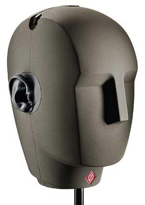

o čem govorimo..
Binaural recording is a method of recording sound that uses two microphones, arranged with the intent to create a 3-D stereo sound sensation for the listener of actually being in the room with the performers or instruments. This effect is often created using a technique known as "Dummy head recording", wherein a mannequin head is outfitted with a microphone in each ear. Binaural recording is intended for replay using headphones and will not translate properly over stereo speakers.
The term "binaural" has frequently been confused as a synonym for the word "stereo", and this is partially due to a large amount of misuse in the mid-1950s by the recording industry, as a marketing buzzword. Conventional stereo recordings do not factor in natural ear spacing or "head shadow" of the head and ears, since these things happen naturally as a person listens, generating their own ITDs (interaural time differences) and ILDs (interaural level differences Because loudspeaker-crosstalk of conventional stereo interferes with binaural reproduction, either headphones are required, or crosstalk cancellation of signals intended for loudspeakers such as Ambiophonics. For listening using conventional speaker-stereo, or mp3 players, a pinna-less dummy head may be preferable for quasi-binaural recording, such as the sphere microphone or Ambiophone. As a general rule, for true binaural results, an audio recording and reproduction system chain, from microphone to listener's brain, should contain one and only one set of pinnae (preferably the listener's own) and one head-shadow.
(vir: vsemogočna nevedna Wikica, več info na http://en.wikipedia.org/wiki/Binaural_recording)
Neumann KU 100 Dummy Head
skratka, treba bo probat..

Kaj je prednost take glave napram dvema pravilno usmerjenima mikrofonoma?
Bi skoraj rekel, da dodatno spremeni zvok zaradi svoje oblike?

p.s. mimogrede, Fritz van der Obglavljeni je lahko vaš za samo 6.590,00 €vropskih.. noro, za kos izložbene lutke z dvema kapsulama..

Kolikor vem, človek zaradi časovnih zamikov (kdaj prispe isti zvok do levega in kdaj do desnega ušesa) lahko določi smer prihajanja zvoka. Ker se to dogaja vglavnem na srednjih tonih, igrajo pomembno vlogo dimenzije naše glave, ker so primerljive z valovno dolžino srednjih tonov - posledično močno vplivajo na obnašanje zvoka okoli glave (difrakcija, fazni zamiki).
Odtod tudi ideja za binauralno snemanje. Ko so probno snemali kamion, ki gre mimo, je bil efekt v slušalkah tako močan, da so poslušalci obračali glavo kot je kamion vozil mimo!
